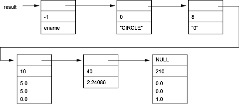

The following figure shows the result-buffer format of a circle retrieved by acdbEntGet():
