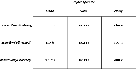

The following table shows the three possible states for opening an object (read, write, notify) and indicates which assert calls succeed for each state. If the object is not open in one of the allowed states for the assert function call, the function does not return. AutoCAD ® exits, and the user is prompted to save the drawing.
