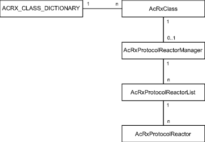

An AcRxProtocolReactorManager object maintains lists of reactor objects registered with its associated AcRx class. These lists are objects of the AcRxProtocolReactorList class. Each manager maintains a separate list for every reactor class type that is registered with its AcRx class. An application uses AcRxProtocolReactorManager pointers to add its custom reactor objects to the appropriate lists. Unlike normal protocol extensions, more than one object of a protocol reactor class may be associated with a single AcRx object, as shown in the following figure:
