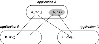

If a function call starts a calling sequence that causes a function in the same application to be called with acedInvoke(), the latter function must be registered by acedRegFunc(). If the called function isn't registered, acedInvoke() reports an error. The following figure illustrates this situation:
In the illustration above,
- A_tan() invokes B_sin()
 - A_tan() invokes C_cos()
 - B_sin() invokes A_pi()
 - C_cos() invokes A_pi()
where application A defines A_tan() and A_pi(), application B defines B_sin(), and application C defines C_cos(). The A_pi() function must be registered by acedRegFunc().
To prevent acedInvoke() from reporting registration errors, register any external function that is meant to be called with acedInvoke().
