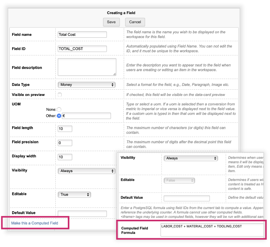

Create a computed field
You can create a new computed field or convert an existing field into a computed one.
  1. From the main menu, go to Administration > Workspace Manager.
  2. Select your workspace, then open the Item Details tab.
  3. Do one of the following:
    • Click Create a Field to add a new computed field.
    • Click Edit a Field to modify an existing field.
  4. In the dialog that appears, click Make this a Computed Field.
  5. Enter your formula in the Computed Field Formula field.
  6. Click Save.
computed field
Note: Computed fields are automatically set to read-only. Users cannot edit computed field values directly.
