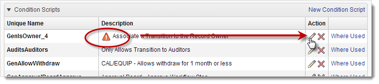

Any time a script fails at run time, the error is logged and an Alert icon Warning Triangle appears next to the script on the Scripting page. You can view the log to get more information about an error.
View Run-time Errors
Runtime error alert
  1. On the Scripting page, click the script's Edit icon icon to open the script in the Script Editor.

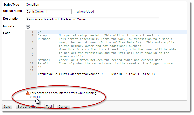

    View error log click
  2. At the bottom of the editor, click View Log.
    View error log
  3. To close the log, click Cancel.
Purge the Error Log
  • At the bottom of the Error Log, click Purge.
