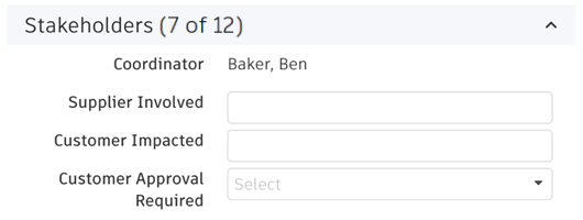

The review may reveal that the change involves a supplier or impacts a specific customer. Additionally, certain types of changes may require customer approval before being released. Such information can be recorded in the Stakeholders section. This information will later be copied to the change order, where customer approval may influence the change approval process.
Stakeholders

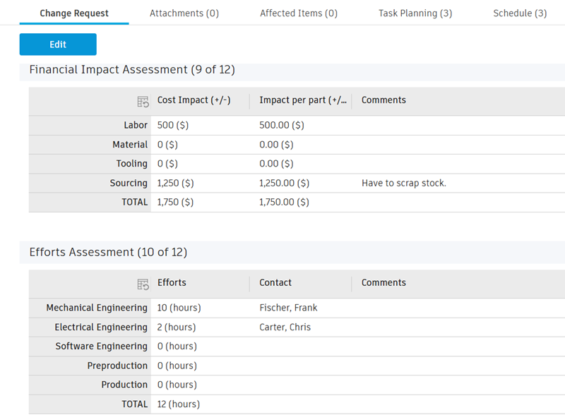

As part of the review and analysis stage, the reviewer must assess the financial impact of the request and the expected efforts. Both can be documented in the Financial Impact Assessment and Efforts Assessment sections respectively. Once figures are provided, the system calculates the totals. This information may be required by the change control board (CCB) to decide on the request's approval, but it is not mandatory. However, if total efforts are defined, they will be copied to the resulting change order as the target effort.
assessments
