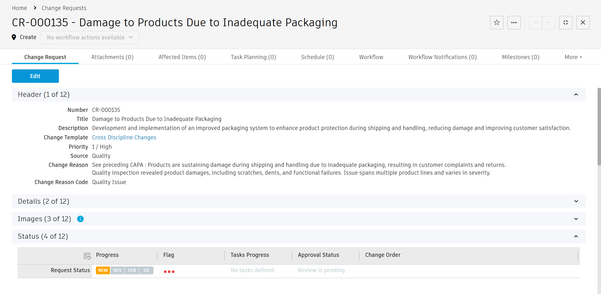

The following sections are available to describe the request:
Section Purpose

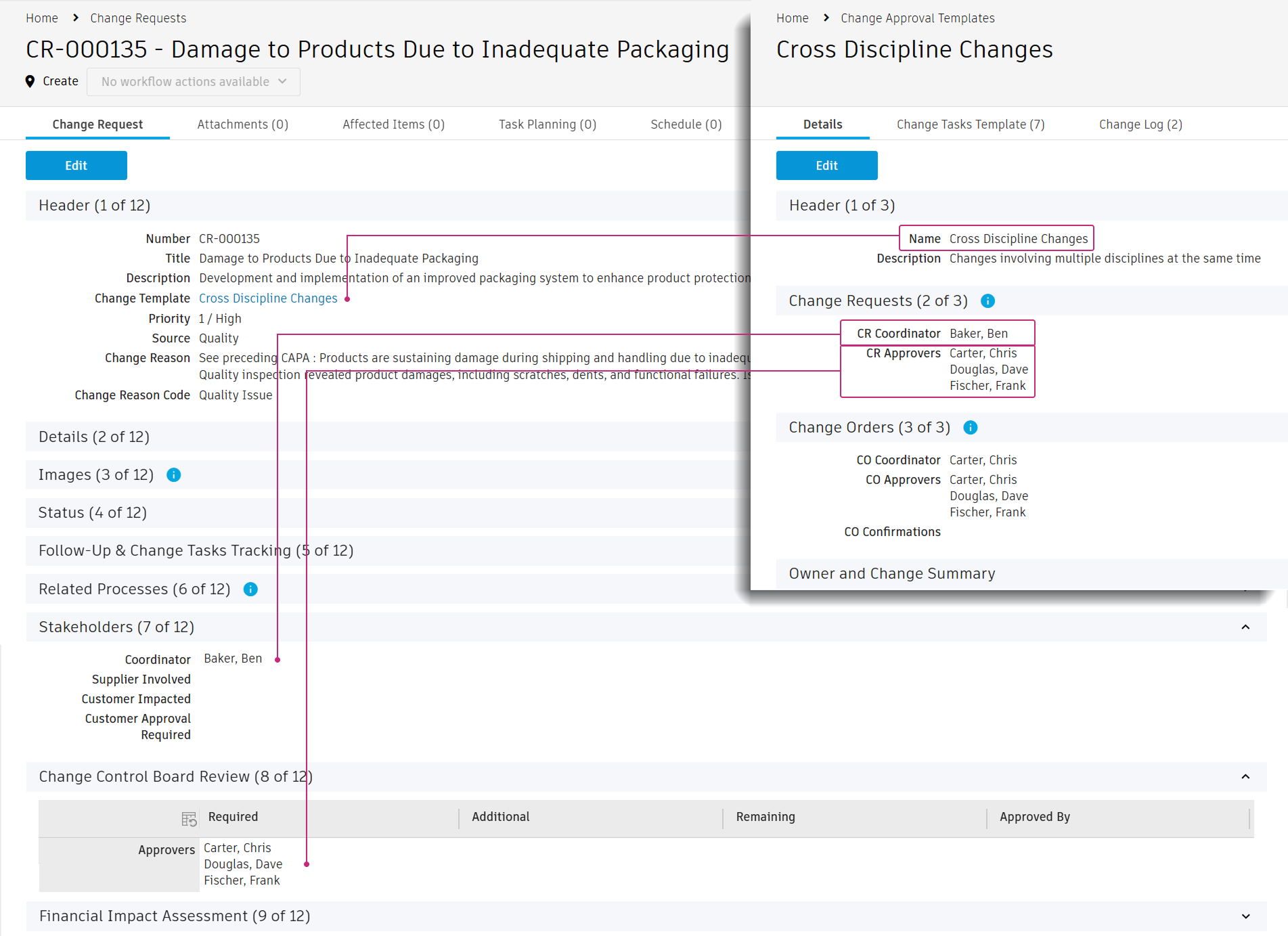

Header Use this section to describe the request. You must specify a Title, Description, and Change Template. You may also specify a Priority, Change Reason and Change Reason Code. When a priority is selected, the Status section shows the priority graphically in the Flag field.
The selected Change Template assigns the responsible coordinator and required change control board (CCB) approvers.

Status This section contains automatic indicators about the overall progress, priority, task progression, and approval status. These fields are especially useful when reviewing a list of requests in workspace views.
- The Progress field reflects the request’s workflow status, such as NEW (new request), REV (review pending), CCB (CCB review due), or CO (Change Order initiated).
- The Flag field indicates the priority of the request.
- The Tasks Progress field shows the completion progress of initiated change tasks.
- The Approval Status field indicates whether the request has been approved or rejected, based on its workflow status. For example, a status of Rejected marks the request as rejected, while a status of Change Order in Progress marks it as approved.

A Change Approval Template must be selected when creating the change request. The template values populate several fields throughout the change request and subsequent change order, where applicable.
change request

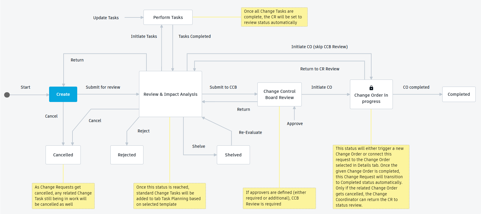

The template also defines the standard change tasks for the request. Once the request is submitted to the Review & Impact Analysis status, tasks from the template that are part of the change request process are copied into the Task Planning tab. This ensures that each change process based on the template follows a consistent set of tasks, helping to maintain defined standards. For more details, refer to Generate and complete change tasks.
Once all details have been entered, you may submit the request for review using the Submit for review workflow action. If the request is no longer valid, it can be canceled to prevent further actions. The request owner can also return the request to the Create state after submission if additional information becomes available.

Cancel a change request
If the request is no longer valid, you may cancel it to prevent further actions to be taken. The following is captured in the Cancellation Details section:
  • Cancelled In Status – The last status of the request before it was canceled.
  • Cancelled By – The person who canceled the request.
  • Cancellation Comments – Comments added when canceling the request.
