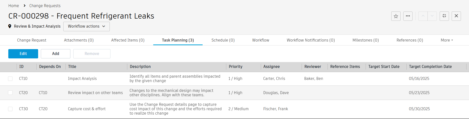

Use the Task Planning tab to define a list of activities to be completed before the change request is submitted to the change control board. When you transition the change request to the Perform Tasks state, the system automatically generates the corresponding change task processes. Once all tasks are complete, the request transitions back to the Review & Impact Analysis status.
You may adjust the tasks in the Task Planning tab — add or remove tasks, or update values such as dependencies, IDs, titles, descriptions, priority, assignee, and target start dates. Start with a standard set of tasks as copied from the template, then tailor them to fit the specific change request.
CR tasks
Each entry must have an alphanumeric ID, an assigned person, and a Target Completion Date. If you define a Reviewer, the system notifies that person when the task results are ready for review and approval. If you do not define a Target Start Date, the system uses the current date.

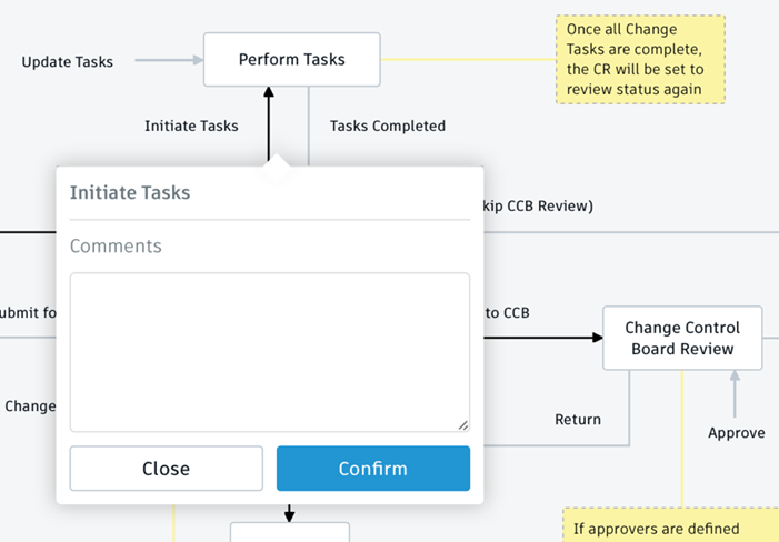

Initiate tasks
Initiate the tasks using the Initiate Tasks workflow action.

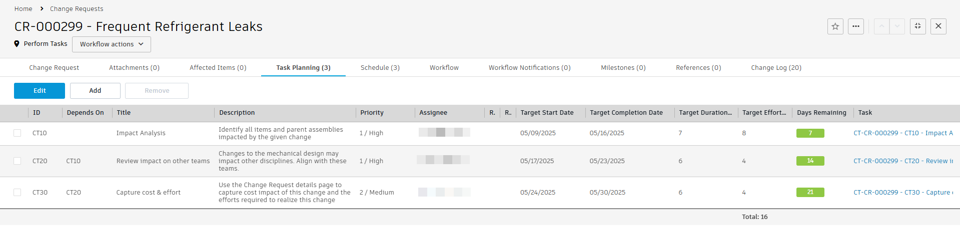

When you complete the transition, the system does the following:
  • Calculates Target Start Dates based on the Target Completion Date and any dependencies specified in the Depends On column. This also determines the values in the Target Duration and Days Remaining columns.
  • Creates change tasks for each entry in the Task Planning tab and places them in the Change Tasks workspace. Each task receives a number in the format <CT> - <CR number> - <ID> – <Title>, making them easy to identify.
  • Shows links to these tasks in the Task column at the far right of the Task Planning tab.

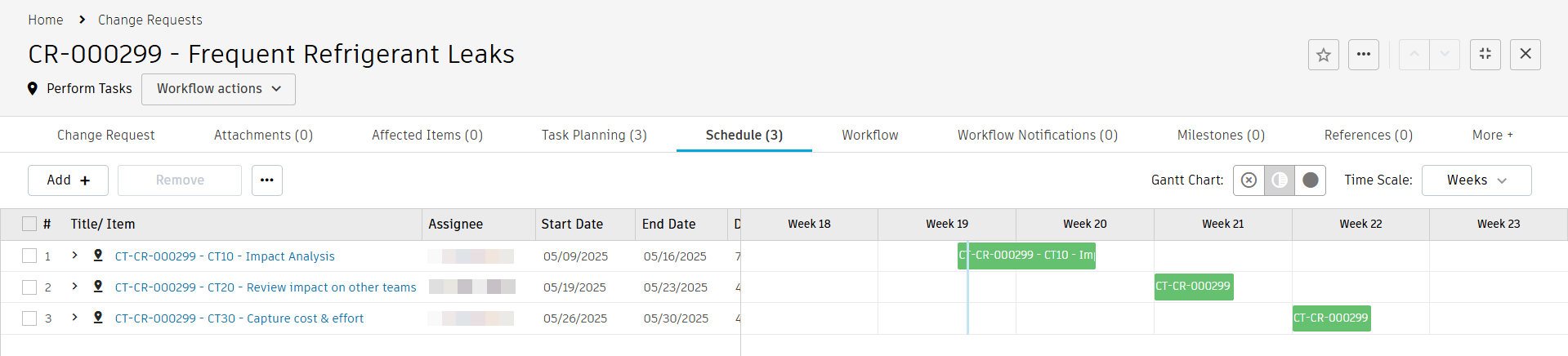

  • Adds tasks to the Schedule tab according to their Target Start and Completion Dates.

The system also adds related change tasks to the Schedule tab so you can track their schedule.

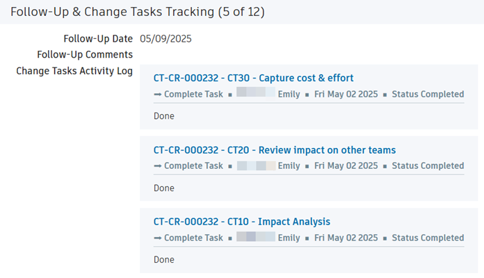

When someone acknowledges or completes a task, or adds comments in the Follow-Up & Status Updates section, the system records the task name and number, status, person, date, and comment in the Change Tasks Activity Log field of the Follow-Up & Change Tasks Tracking section of the main Change Request tab. Each task has its own entry, but only the latest activity appears for each. This helps the change coordinator track the latest task activities and monitor overall progress.

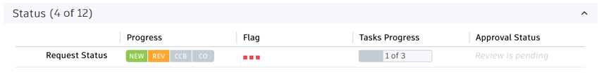

You can easily track completion of related change tasks using the Tasks Progress field in the Status section, which counts the number of completed tasks:
