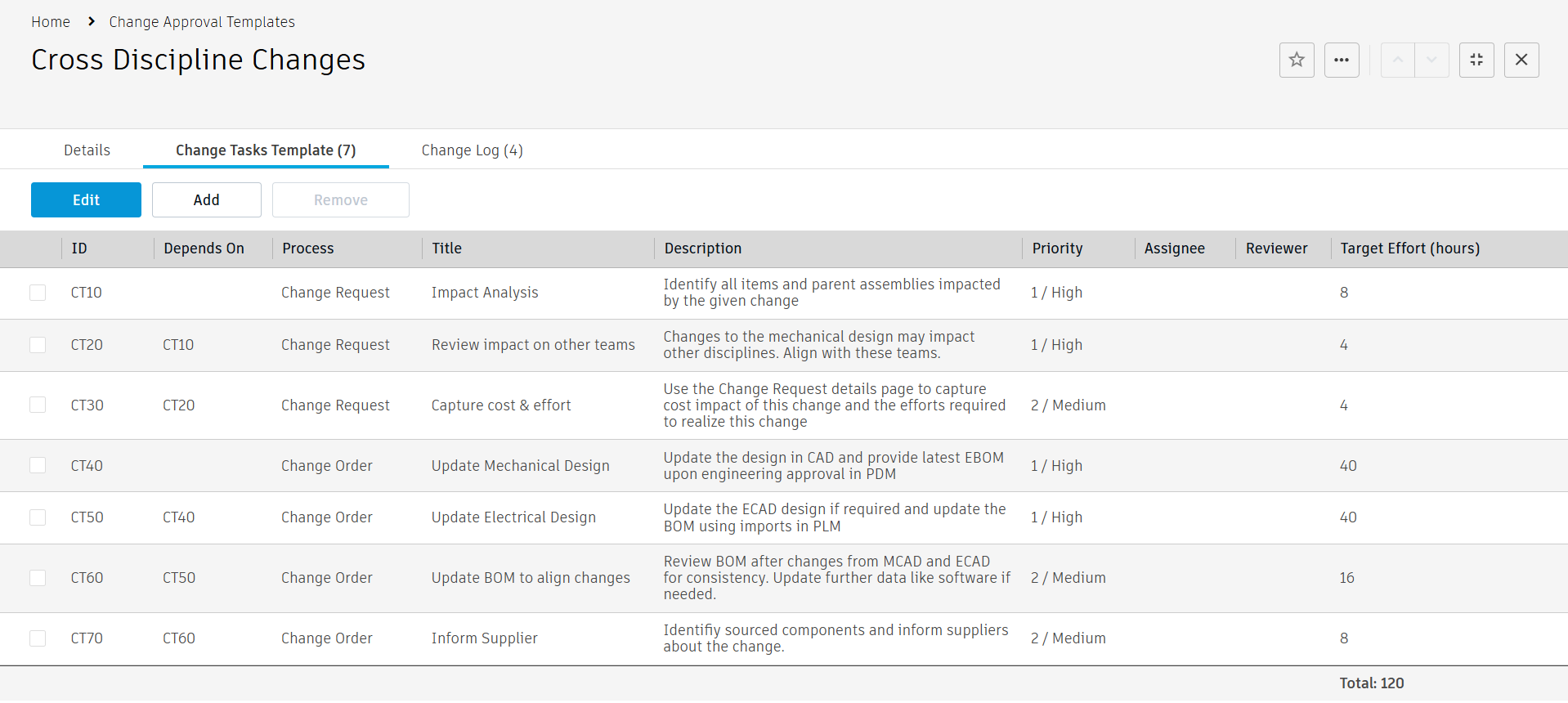

Target efforts in the change approval template
When you define the standard set of tasks on a change approval template, you may enter target efforts to provide guidance during change execution.
Change Tasks Template tab

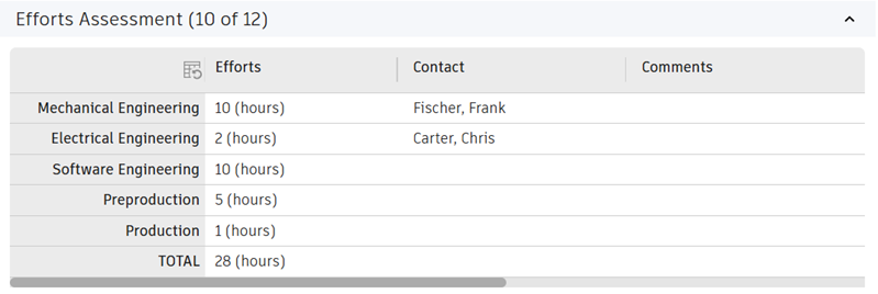

In addition to this, you may also break down the planned effort for the change request in the Efforts Assessment section of the main tab of the CR.
CR effort

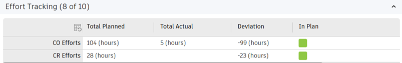

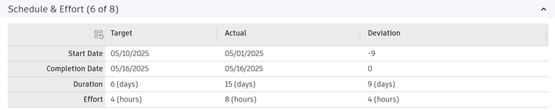

Actual effort across the change process
As you complete tasks for both CRs and COs, you enter actual effort in the Efforts tab of the tasks. When you complete the task, the system adds the total actual effort for that task to the Schedule & Effort section of the main tab of the task.
task effort
Actual effort is tallied across all tasks for the CR and CO and added to the Total Actual column in the Effort Tracking section on the CO. This makes it easy to view and compare expected and actual efforts across the entire change process in one place. This may help you better plan for the next change process and adjust the change approval template accordingly.
effort totals
