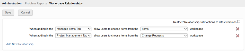

Workspace relationships for problem reports
Problem reports should be configured to allow Items in the Managed Items Tab:

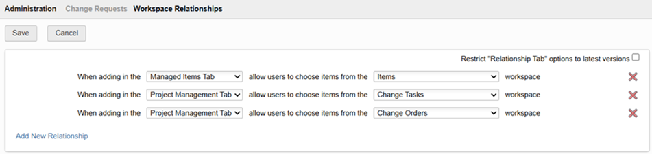

Workspace relationships for change requests
Change requests should be configured to allow Items in the Managed Items Tab:

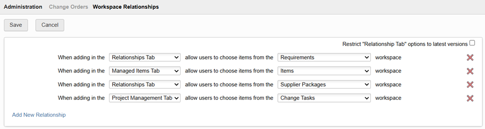

Workspace relationships for change orders
Change orders should be configured to allow Items in the Managed Items Tab:
