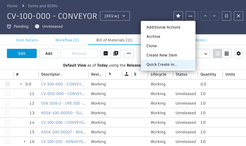

From the item to be released, create the new Quick Release by using the Actions menu. Select Quick Create in…
Actions menu

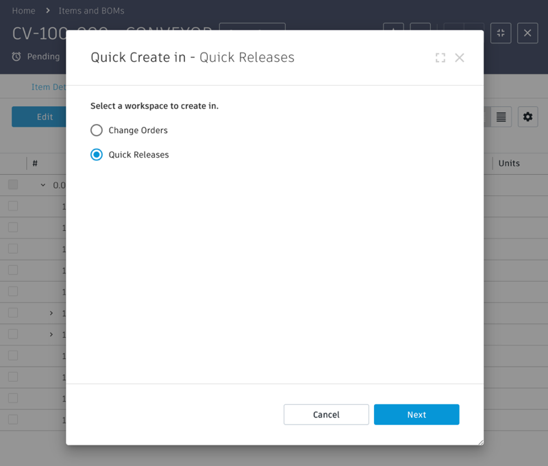

As multiple processes can be used to perform the Pre Release, you have to choose the right process first. Select Quick Releases:
Quick Create in Quick Releases dialog

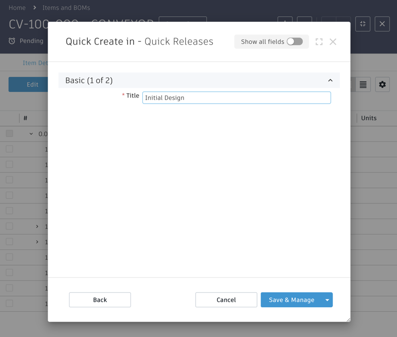

Provide a title for the process in the quick create dialog:
If you want automatic notifications to be sent to defined users, click the ‘Show all fields’ toggle at top. This will display all process data, including the ‘Distribution List’. Select the users to be notified in here.
Click on Save& Manage when done.
