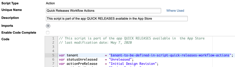

Using the Script Editor of Fusion Manage, perform the following changes in the Action script “Quick Releases Workflow Actions”:
  1. Provide the name of your tenant in line #5
    Action Script
    Replace the placeholder string with the name of your tenant without the suffix autodeskplm360.net.

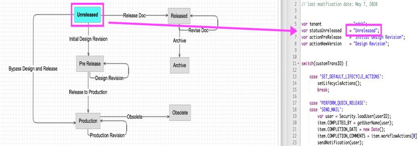

  2. Set the standard lifecycle status
    Make sure that the variable in line #6 matches the name of your standard lifecycle status in the Lifecycle Editor. If you’re using a standard configuration, the code should match already.

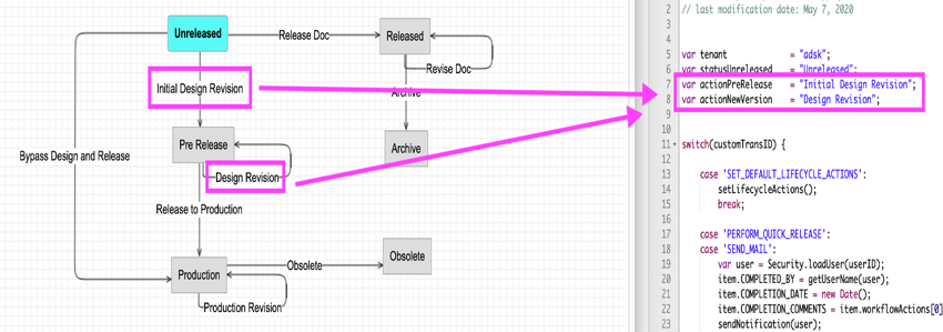

  3. Set the standard lifecycle transitions to state Pre Released
    Provide the names of your transitions in lines #7 & #8. If you’re using a standard configuration, the code should match already.
