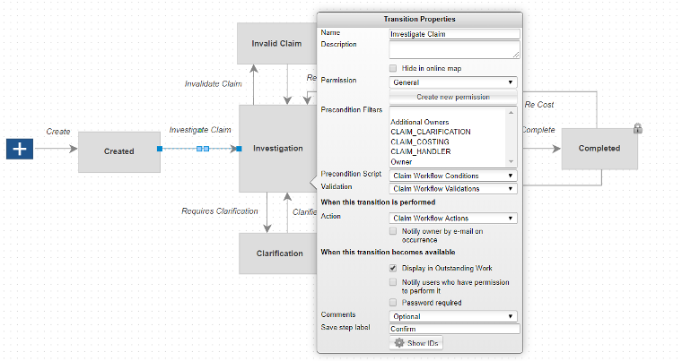

In this example we will invoke the script on the Investigate Claim transition. As we can see in the illustration below, we already have an existing script defined - Claim Workflow Actions
The exiting script can be extended with the following line of code to invoke the reminder utility. The script should also import the library Reminder Utility Library.
setTimer("CLAIM_HANDLER","CLAIM_HANDLER_TARGET_DATE","","1");
