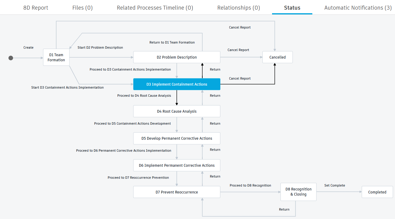

The eight disciplines (8D) model is a problem-solving approach to identify, correct, and eliminate recurring problems, making it useful in product and process improvement. The 8D Report workspace contains records of each 8D process that uses a workflow to work through each of the eight steps. Here we lay out the process of creating an 8D report, defining the team, describing the problem, and working to a solution.
Note: Many sections within an 8D report have this icon info icon beside them. Click this icon to view more information about filling in the section, including what fields are required.
The 8D Reports template comes with the following workflow.
8d workflow
