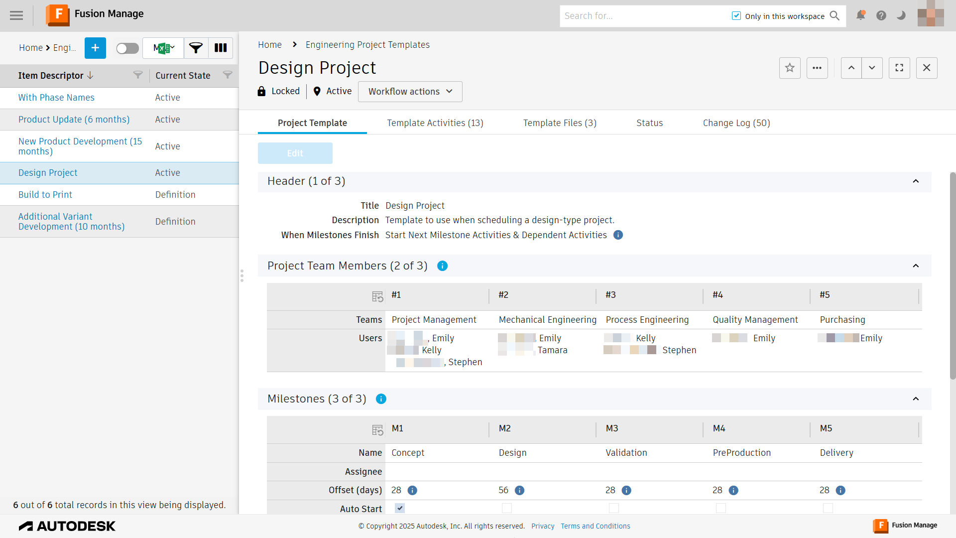

Engineering project templates are used to define the overall structure of a new project. The template defines the default set of tasks and their duration. You can also optionally define responsible teams and team members as well as expected efforts for each task.
Important: You cannot create an engineering project without first creating a template.
Find all templates you and your team have created in the Engineering Project Templates workspace.
eng proj templates
