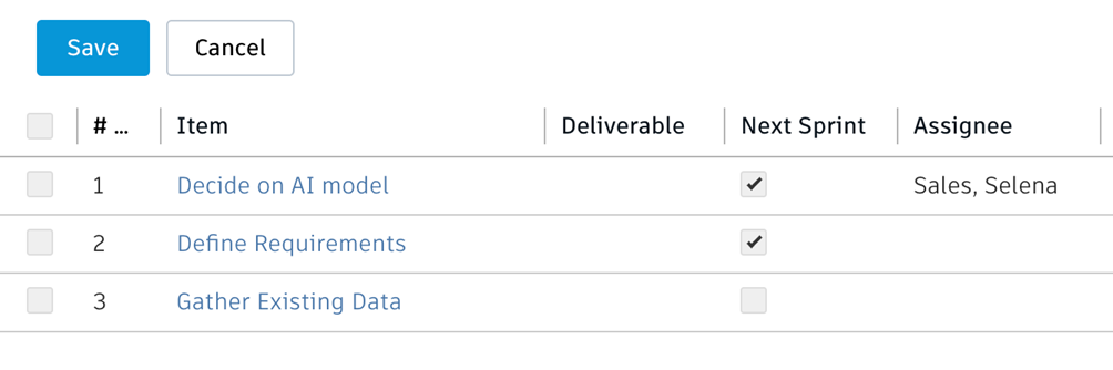

Add activities to a sprint
  1. Open the Activity Backlog tab.
  2. Click Edit.
  3. In the Next Sprint column, select each activity to add to the next sprint.
  4. Click Save.
