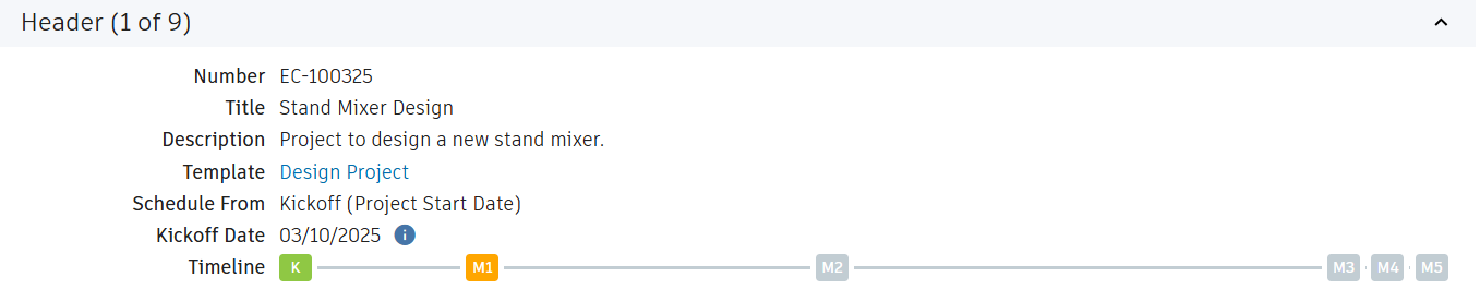

In the main Engineering Project tab, the Header section shows the kickoff date with a visual display of the current milestone.
project header
The squares follow a specific color coding:
  • Grey - Not started
  • Orange - In progress
  • Red - Awaiting Gate Approval
  • Green - Complete

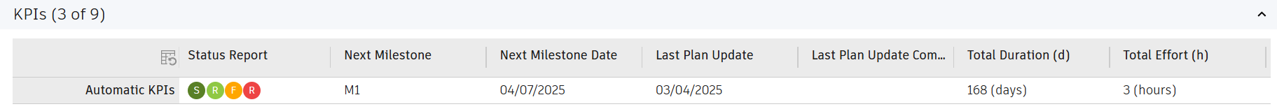

KPIs & Status Report
The KPIs section shows key information about the project.
The Status Report column shows the status entered in the Status Report section. The letters S, R, F, and R reflect the drop-down entries made in the Schedule, Resources, Feasibility, and Risks columns respectively.
epm kpis
The colors indicate the status of each area.
  • Dark green - Above plan
  • Green - In plan
  • Orange - At risk
  • Red - Critical
The KPIs section also indicates what the upcoming milestone is, when that is expected to start, when the plan was last updated, any comments added when it was updated, how many days have already passed in the project, and the total effort logged so far.

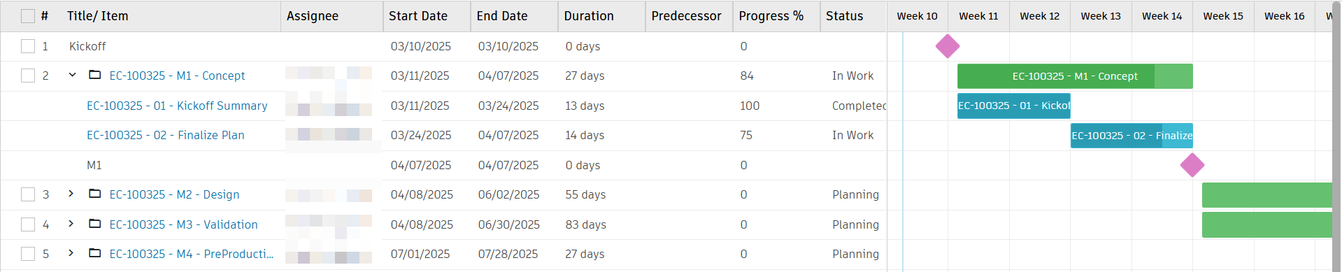

Gantt chart
The Gantt tab captures status information of each activity. On the Gantt chart, part of the bar representing the total activity length is darkened to visually indicate how much progress has been made on the activity. Part of the parent milestone activity is also darkened to indicate the overall progress of the milestone.
gantt progress
