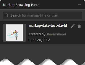

Manage your markup
To download a screenshot of your markup, click Save > As screenshot in the Markup Management bar.
To save your markup with the design, click Save > As data.
The markup is recorded in the Markup Browsing Panel on the left side of the window.
To load a recorded markup, click it in the Markup Browsing Panel.
In the Markup Browsing Panel, you can rename
or delete
saved markups.To clear markup and start over without deleting any saved markup, click Create New in the Markup Management bar.
Click Done to return to the attachment viewer.
