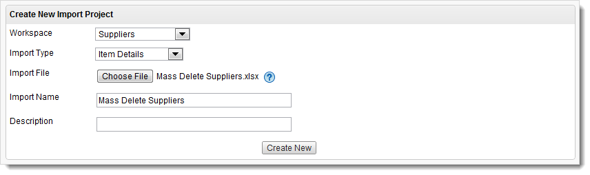

Create the Import Project
  1. From the navigation menu, select Advanced Tools > Imports.
  2. Select the Workspace.
    import delete project
  3. Select Item Details as the Import Type.
  4. Click Choose File and select the Excel file you saved in the previous section.
  5. Enter a Name for the project.
  6. Click Create New.

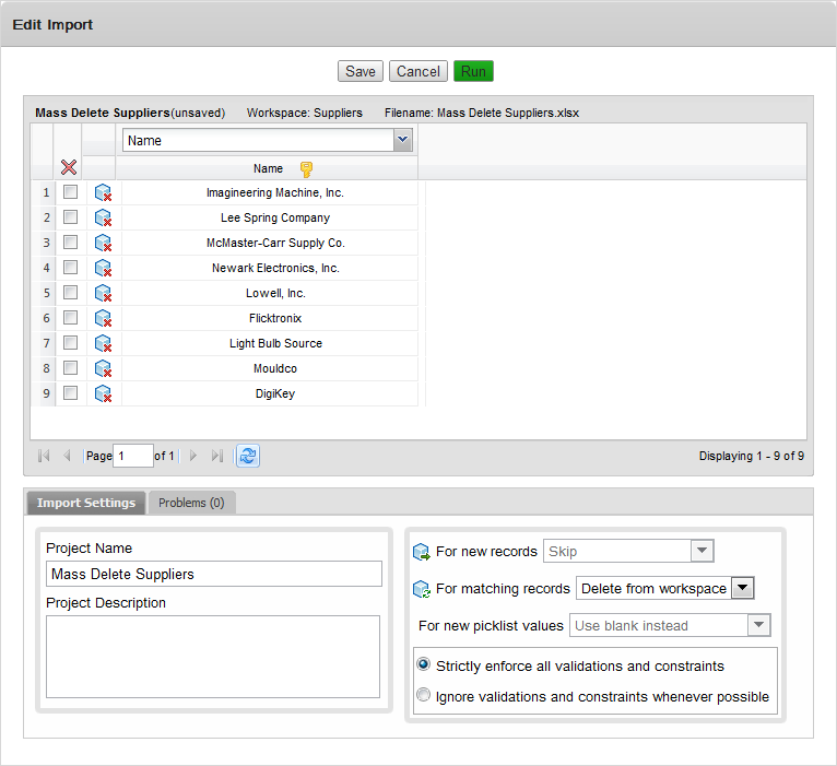

Edit and run the Import Project
  1. On the Edit Import page, select Match On in the drop-down list of the Name column header.
  2. In the Import Settings panel, select Delete from workspace in the For matching records drop-down list.
  3. Click Refresh.
    import delete edit
    Tip:
    You do not need to delete all the items in the workspace. To delete only some items in the workspace, turn off the delete checkbox in the rows to keep.
  4. Click Save.
  5. Click Run.
  6. In the import confirmation box, click Proceed.
