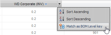

  2. Locate the column in the Excel sheet that represents the BOM levels. Click the header for the level column and then select Match as BOM Level key to indicate that this column will be used to determine the BOM structure when it is imported.
    match level key
