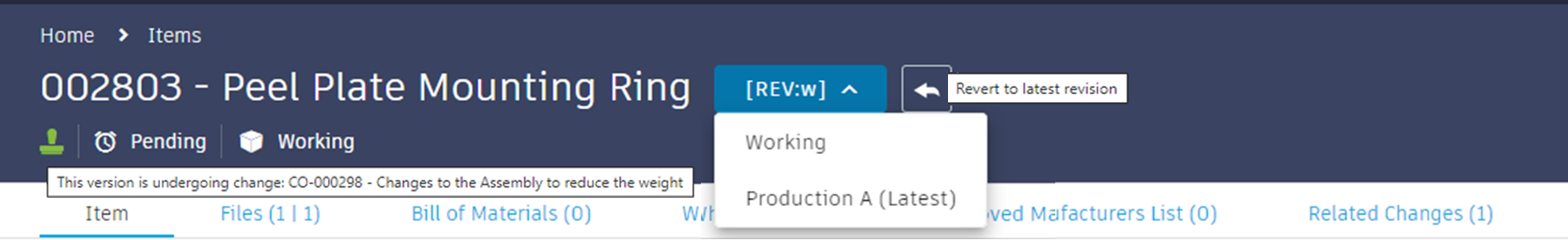

Item Header
The item header identifies an item by its descriptor and, depending on the workspace, shows workflow, lifecycle, and revision information.
For items in a revision-controlled workspace, the header includes the item descriptor, the lifecycle state, and revision of the item. An item undergoing a change is identified with a green stamp. Place your pointer over the stamp icon to view details about the change order. Click the stamp to navigate to the change order. If the working version is not locked, click the revision drop-down to revert the working version to the latest revision.
