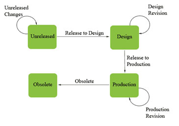

As items are revised, they go through lifecycle phases. These phases and the transitions between them can be tailored by your administrator, but in most cases these phases are:
- Unreleased – Newly created item in a revision-controlled workspace. It can be modified by anyone with edit rights to the workspace. Unreleased items typically represent a specification/definition of an item or product.
- In Design (or Working) – Item is in development. Design iterations create numerical revision numbers for each item.
- In Production – Item is released into production.
- Obsolete – Item has reached its end of life and is no longer produced.

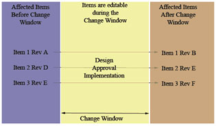

The items in the revision-controlled workspaces are associated with the revisioning workspace item through the Linked Items tab (see Linked Items). When revision-controlled items are added in this way, an open change window is created for these items.
A green stamp displays on the working version of a Revision Controlled item when it is managed by a revisioning item.

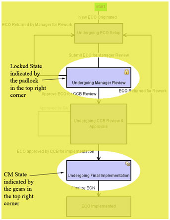

The Revisioning Workspace has workflow defined with a specific state called the Change Management State or CM State. Once this state is reached, the linked items are transitioned to the next phase of the lifecycle defined for each item, and the change window is closed. Optionally, the change window is closed earlier if a Lock State is specified that comes before the CM State is reached.

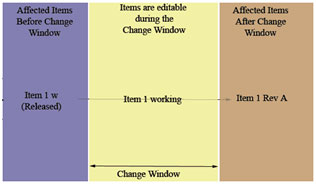

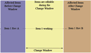

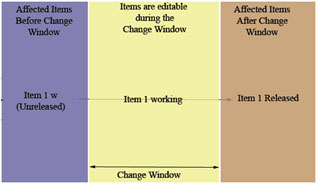

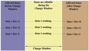

Changes to items in a Revision-Controlled Workspace can occur only when an item is Unreleased or when a change window is opened via the Revisioning Workspace. In either case, any changes are applied to what is called the "Working Version."
Unreleased items are such that the working version is the latest and only version. These items appear with an asterisk in the item selection list. When referenced in a bill of material these items are shown with a lower case w as the revision number to indicate this is an unreleased working version. When an unreleased item is released via the CM workspace the working version becomes hidden until the next change window.
The working version of a released item once again becomes available for modifications upon creation of a new change window.
When a released item is revised via the CM workspace the previous release becomes superseded and all references to this superseded item in all the bills of material are updated to point to the new revision once the CM State is reached.
