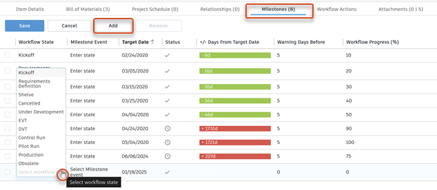

Add a Milestone
If you have permission to add a milestone to an item, Add is enabled on the Milestones tab.
  1. Click the Milestones tab.
  2. Click Add.
    add milestone
Edit a Milestone
  1. Select the workflow state to associate with the milestone.
  2. In the Milestone Event column, select Enter state or Leave state to reflect a transition to or from the workflow state.
  3. Select a Target Date for reaching the milestone event.
  4. In the Warning Days Before column, enter a number of days before the target date to define a warning period for the milestone (optional).
  5. In the Workflow Progress (%) column, enter the percentage of progress through the workflow at the completion of this milestone (optional).
  6. Click Save.
