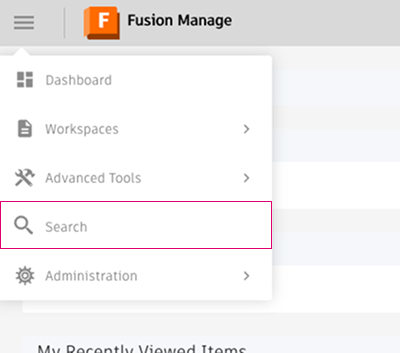

From the Navigation Menu:
  1. Click the main navigation menu main navigation menu.
  2. Select Search from the list.
    search main navigation

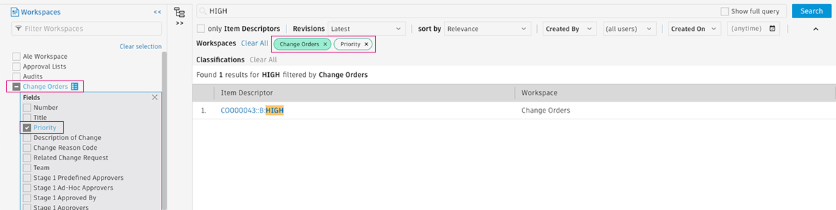

  1. Enter a search term in the field at the top of the page.
  2. Use the filter browsers on the left side of the page to refine your results:
    Workspace filters:
    • Select a workspace or expand it to filter by specific fields.
    • Click the checklist checklist next to a workspace to see available fields.
    • Selected workspaces appear as green tags. Selected fields appear as outlined tags.
      Workspace filters selected

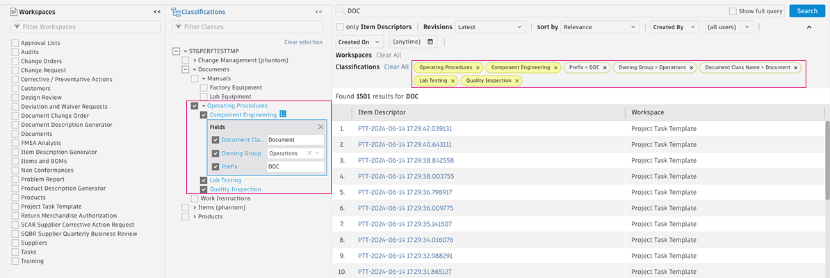

    Classification filters:
    • Select a class or expand it to filter by its specific properties.
    • Click the checklist checklist next to a class to see its properties.
    • Enter values for properties to refine your search further.
    • Selected classes appear as yellow tags. Selected properties appear as outlined tags.
      classification filters selected
