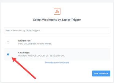

    Select Choose Trigger
  3. Select Catch Hook.
    Select catch hook
  4. Click Save + Continue.

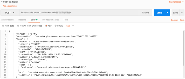

  8. Issue a call to Zapier and the sample payload, to configure the hook.
    1. Create a new call, change the verb to POST.
    2. Fill in the callback URL you received from Zapier.
    3. Click the Body tab, paste the sample payload from the item update as raw data.
      alt
    4. Make sure Zapier is listening for the call.
      It will display Looking for the hook, this might take a sec...)
    5. Press Send.
      Be aware that Zapier times out after a while, so check the tab and Try again if needed.
      You should get a 200 OK response from the POST.

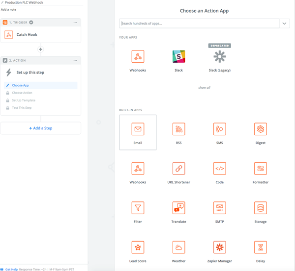

  11. Select E-mail from the list of actions available.
    e-mail action

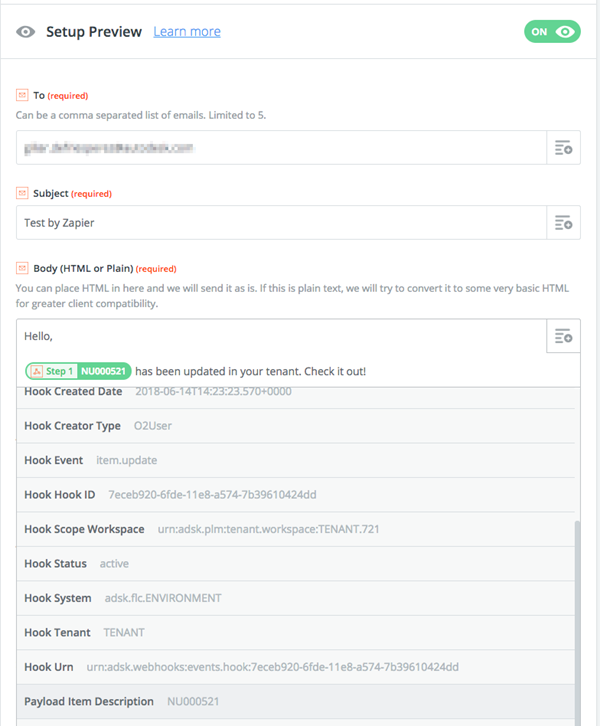

  12. Set up the action.
    Zapier will parse the payload supplied by the callback. Zapier is a very visual tool – by clicking the buttons on each input field, you’ll be able to pick and choose different parts of the payload to build your e-mail.
    Setup preview
    If you performed step 7a, You have finished. Updating an item in your workspace should trigger this Zap, and you should be getting e-mails in your inbox.
