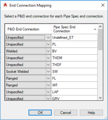

Share Email Facebook Twitter LinkedIn End Connection Mapping dialog box P&ID End Connection Lists the P&ID end connections available to be mapped to the Pipe Spec values. Pipe Spec End Connection Lists the Pipe Spec End Connections that to be mapped to each P&ID end connection. Parent topic: Pipe Specs in P&ID dialog box
