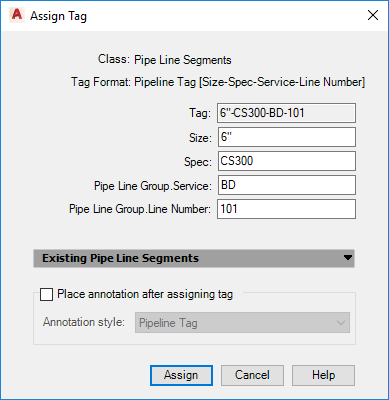

  3. In the Assign Tag dialog box, do the following:
    • In the box labeled TargetObject.Number, enter the line number (for example: 101).
      To create an unassigned pipe line, leave this box blank.
    • In the Spec list, click a spec (for example: CS300).
    • In the Size list, click a size (for example: 6”).
    • Click Assign.
