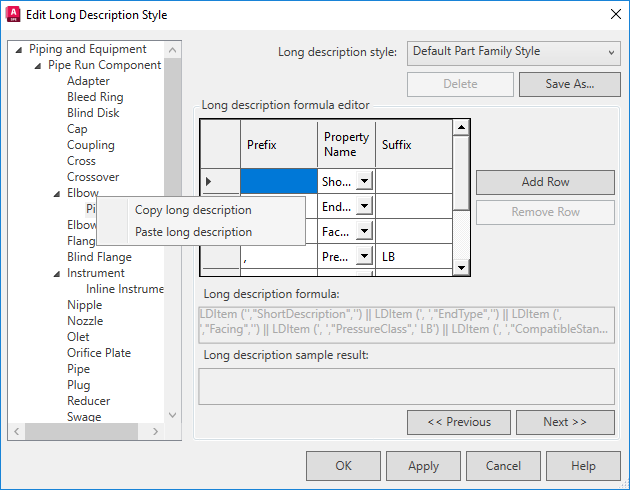

Edit Long Description Style Dialog Box
Edits, overrides, modifies, and saves the long description formula.
List of Options
Part tree
Lists all parts in an expandable hierarchical tree. If you right-click a part, you can copy the long description. If you right-click another part, you can paste the long description.
Long description style
Lists the default style (originating from the catalog) along with any you create.
Delete
Deletes long description styles you have created. You cannot delete the default style.
Save As
Saves the selected long description style to the Long Description Styles folder (the default).
Long description formula editor
Creates a formula for a long description style
Prefix
Adds a prefix to the formula. Enter a string value.
Property Name
Lists the catalog properties of the selected part. If the currently open spec contains additional properties, these are listed below the catalog properties.
Suffix
Adds a suffix to the formula. Enter a string value.
Add Row
Creates a blank row at the bottom of the formula editor table.
Remove Row
Deletes the row selected in the mapping table. You can select a row by clicking in the left column. You can press SHIFT, CTRL, or CTRL+A to select multiple rows.
Displays (as read-only text) the formula you have created.
Long description sample result
Displays (as read-only text) a sample result of the formula you have created. The first record of the selected part type in the default catalog is shown.
Previous
Displays a sample formula for the previous record if one exists.
Next
Displays a sample formula for the next record if one exists.
