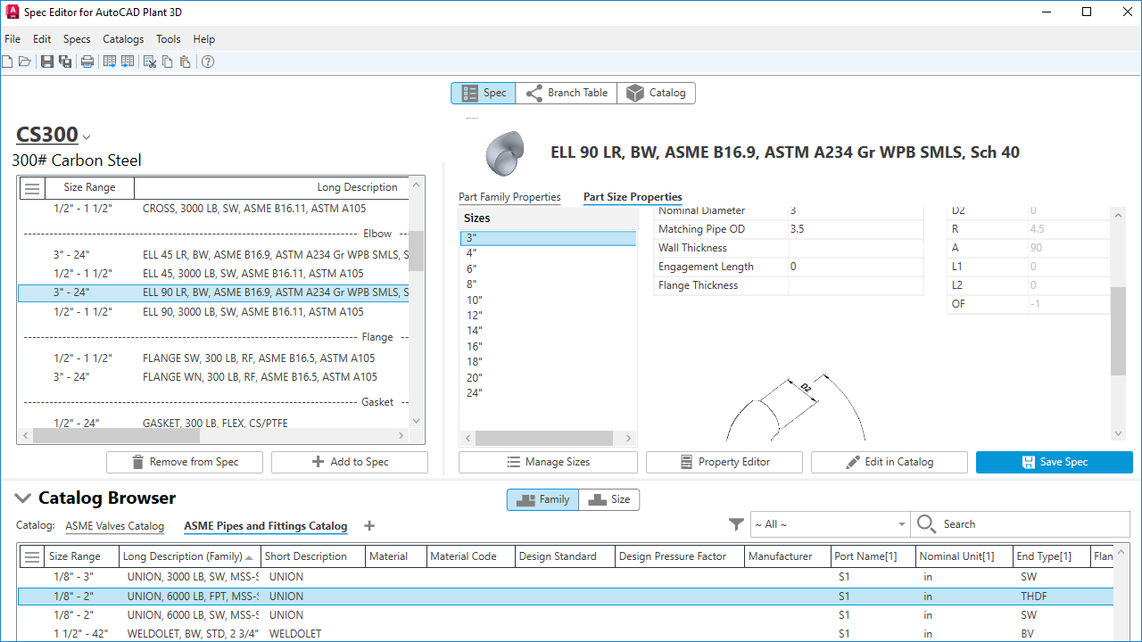

Spec Editor Enhancements
This release brings key improvements to the Spec Editor, enhancing flexibility and efficiency in managing specs, editing properties, and filtering catalog items.
Spec Tab
The Spec drop-down list is now scrollable when the menu overflows. The Open Spec and New Spec options are always visible and pinned to the bottom when scrolling through specs in the drop-down list.
A new "Remove from Spec" option has been added to the shortcut menu when clicking one or multiple parts in the Spec sheet. You can also remove parts by pressing Delete on your keyboard. After removing parts from the Spec in the Spec Sheet, the selection automatically moves to the next item.
Branch Table Tab
Edit the spec description from the Branch Table tab, just as you do in the Spec tab. Changes made in the Spec tab or Branch Table tab can be synchronized between the two.
Part List Tab (Property Editor Dialog Box)
Click any cell in the part list table within the spec or catalog property editor dialog boxes to enter an edit mode and make changes. You can also make changes in the cell using shortcut keys such as Ctrl, Ctrl+A, Shift, Enter, Tab, Esc, Delete, and arrow keys.
Additionally, you can select multiple cells, and use the Enter or Tab key to switch between edit and selection modes, or the Tab or arrow keys to switch between different cells in selection mode.
You can edit one or multiple cells simultaneously. When clicking any Size cell in the part list table, the whole row is selected. Moreover, you can copy one or multiple rows and paste them into an Excel spreadsheet, including property headers when copying the whole table.
Catalog Browser
You can now filter multiple sizes in the Size tab. After enabling the property filter in the Size Tab, size check boxes display in the list when you expand the Size column. You can select one or multiple size check boxes to filter results.
Note: The checkbox selection only applies to the Size column in the Size tab.
In addition to clicking the Remove from Catalog option from the shortcut menu, you can also remove parts by pressing Delete on your keyboard.
