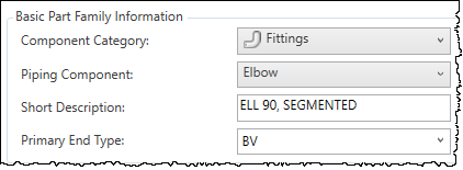

  3. Under Basic Part Family Information, do the following:
    • Choose a component category (for example, Fittings).
    • Choose a piping component type (for example, Elbow).
    • Enter a short description (or example, ELL 90, SEGMENTED).
    • Choose a primary end type (for example, BV).
      You can also enter a value if the primary end type is not in the catalog.

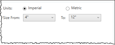

  6. Under Basic Part Family Information, specify an initial size range (for example, 4” to 12”).
    Sizes can be added and removed after the part is added to the catalog.
