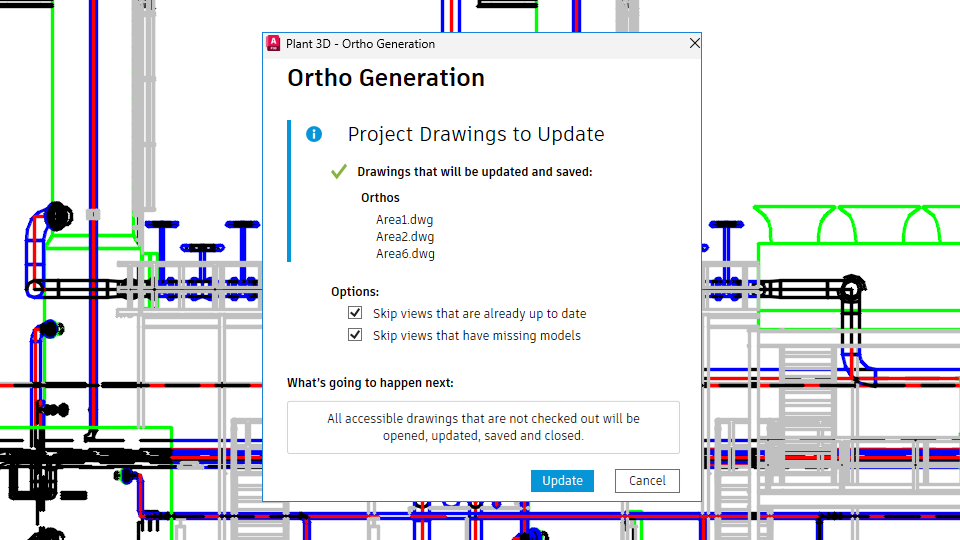

The Ortho Generation dialog box now includes two options to accelerate the ortho generation process:
  • Skip Views That Are Already Up to Date: This option ignores views that are already up to date during ortho generation.
  • Skip Views That Have Missing Models: This option ignores views with missing models during ortho generation.
Also, you can now display the direction of equipment nozzles in the Ortho Nozzle list, whether it matches the nozzle attachment port or the nozzle port, using the new PLANTORTHONOZZLEDIRECTION system variable.
