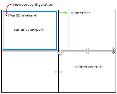

When you display multiple viewports, the one that is highlighted with a blue rectangle is called the current viewport.

You can modify the size, shape, and number of model space viewports in a viewport configuration:
  • Choose from several viewport configurations by clicking the [+] or [-] control in the top-left corner of a viewport.
  • Drag the boundaries of viewports to adjust their size.
  • Press CTRL while dragging viewport boundaries to display the green splitter bar and create new viewports. Alternatively, you can drag the outermost splitter controls.
  • Drag a viewport boundary onto another boundary to remove a viewport.
