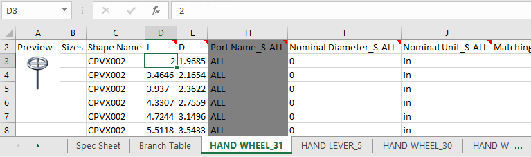

Edit exported spec data
  1. Open the exported Excel file.
  2. Go to the tab of the part you want to edit.
  3. Edit the content you want to change.
    Note: Some fields are write-protected so they should not be edited.
  4. Save the file.
Change a spec part description using Excel formulas
  1. Open a spreadsheet that was exported from a spec (for example:C:\AutoCAD Plant 3D 2026 Content\\CS300.xlsx).
  2. Click the part family tab to make it the active worksheet.
  3. Right-click the header of the Part Size Long Desc column. Click Format Cells.
  4. In the Format Cells dialog box, click General.
    If the cell type is Text, you cannot create a formula.
  5. Click OK.
  6. Click to highlight a cell that you want to modify (for example: F2).
  7. In the Formula bar, enter a formula. For example:
    =G2 & " w. hand lever , " & H2 & "nd, " & I2 & ", " & AB2 & "lb ," & X2
  8. Hover over the right corner of the cell and when the mouse changes to a plus symbol, click it and drag over the cells below so they have the same formula.
  9. Save the Excel spreadsheet and exit Excel.
