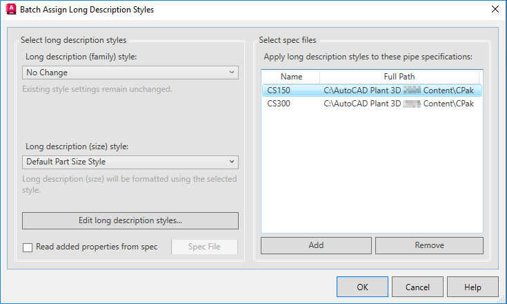

To batch assign long description styles
Note: Close any open specs before making batch assignments.
- In the Spec Editor, click Specs menu
Batch Assign Long Description Styles.
- Under Select Long Description Styles, click the Long Description (Family) style drop-down list. Click a style.
- Under Select Long Description Styles, click the Long Description (Size) style drop-down list. Click a style.
- (Optional) Click Edit Long Description Styles to create or modify styles.
- Click Add. In the Windows Open dialog, navigate to the specs to be updated. Repeat this step as needed to compile a complete list.
- Click OK. Depending on the number of specs in the list, the process takes more or less time.
