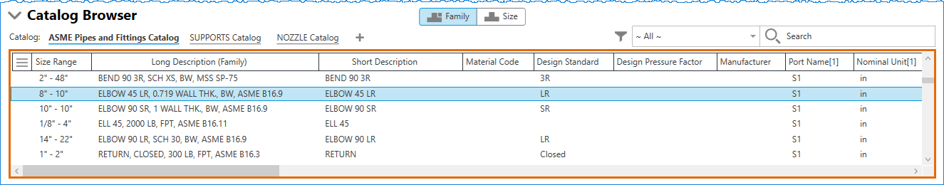

The Catalog Browser is located at the bottom panel of the Spec and Catalog tabs. It displays everything from a catalog with customization and filtering functionality.

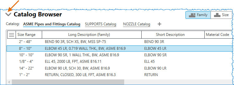

Expander
You can click on the expander to expand or collapse the Catalog Browser. Collapsing the Catalog Browser provides more visibility of the Spec and Catalog tabs for editing components.

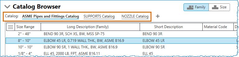

Catalog Tabs
The catalog tabs display all opened catalogs. The active catalog is highlighted with bold text.
You can perform the following actions with catalog tabs:
  • Click a catalog name to switch the active catalog.
  • Right-click a catalog name to close it.
  • Click the plus (+) button to open a catalog.

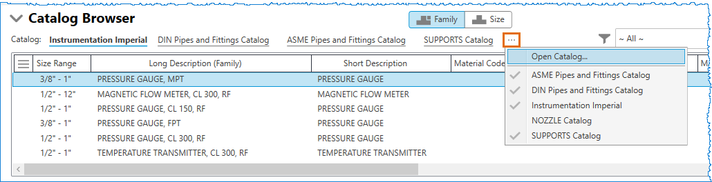

    The (+) button changes to the ellipsis button (…) button when there are too many open catalogs.
  • Click the (…) button to view all open catalogs and switch between them or open a new catalog.

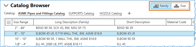

Family and Size Toggle
You can switch between the Family and Size tabs to display the components list by part families or part sizes.

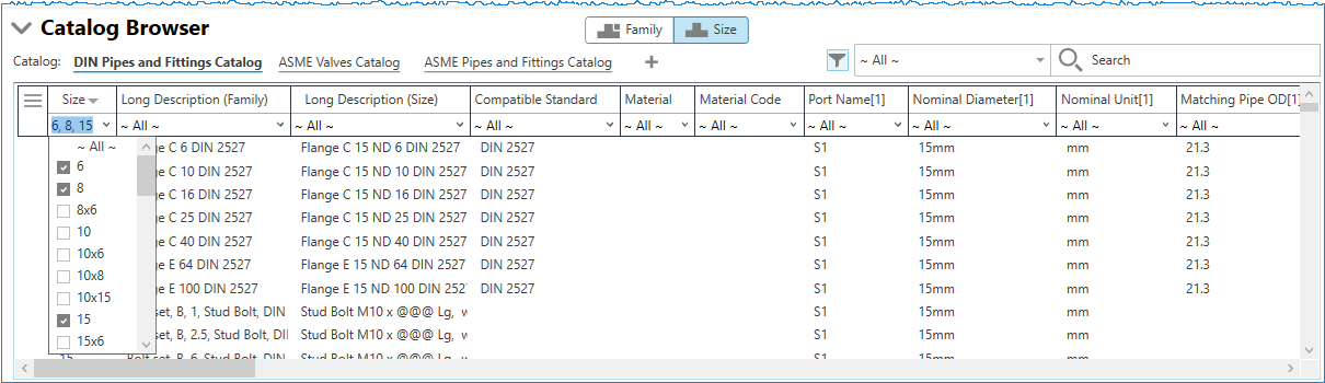

Search and Filter
The search function helps find parts with particular keywords quickly. The property filter helps filter parts with desired property values.
Enable the property filter by clicking the left side of the search bar. Clear all property filters by clicking the same button again. The property filter displays right under the property name in the components list. The available values of each property filter are updated to show only valid values with an active search.
When the property filter in the Size tab is enabled, you can select multiple sizes by clicking the appropriate checkboxes.
Active search and filters are saved for each opened catalog and cleared when the catalog is closed. Switching the active catalog does not lose the search and filters; they are restored when the catalog is switched back to active.
