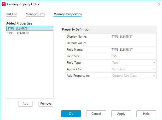

Manage Properties (Catalog Property Editor Dialog Box)
Adds and modifies property definitions in a catalog.
List of Options
Adds new properties and sets property definitions for the current selection or for a selected group of parts.
Added Properties
Lists added (custom) properties.
Add
Adds a property using the values specified in the Property Definition.
Remove
Deletes a property in the list.
Property Definition
Defines the added properties.
Display Name
Sets the property display name.
Default Value
Sets the property default value.
Field Name
Sets the field name.
Field Size
Sets the size of a text type. You can specify a size that is from 1 through 255 characters.
Field Type
Sets the property type. You can specify a text, numeric, or a check box type (True/False).
Note: If you specify a Text type, a field size is required. If you specify a Numeric type, specify a default value. If you specify a check box, specify a default value of either True or False.
Applies to
Applies the property to part sizes, or to a part family.
Add Property to
Adds the property to the selected parts, or to all parts.
