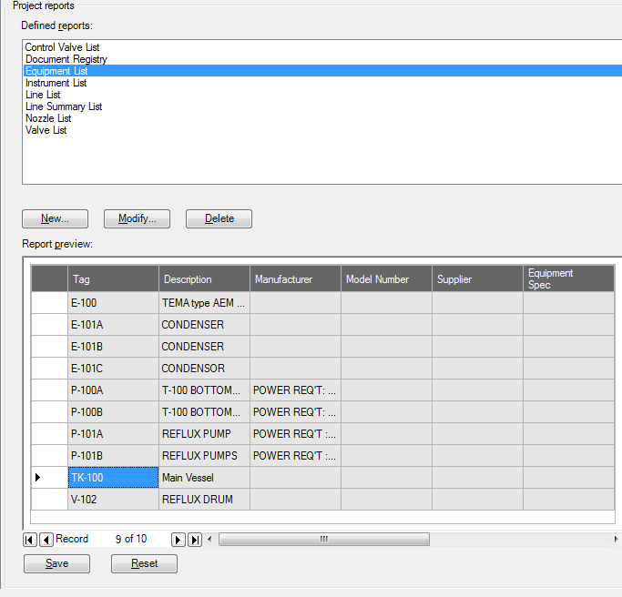

Defined reports
Lists the reports that users can view in the Data Manager.
- New
Displays the New Report dialog box, where you create a new report based on an existing one.
- Modify
Displays the Modify Report dialog box, where you can modify existing reports.
- Delete
Deletes a report.
Report Preview
Shows the specified report as it will be displayed in the Data Manager. You can sort by clicking the column headings. Using the right-click menu, you can filter by the selection, by excluding the selection, or by specifying values.
Note:
Surround a string entry with single quotation marks (‘). Entries are case-sensitive.
| Conditions (can be used cumulatively) | Purpose | Examples |
| Angle brackets (< >) | to display values not equal to your entry |
| Equal signs (=) | to display values that match your entry | = ‘Bosch’ displays only cells containing the string Bosch |
| IS NULL | to display only empty cells | Displays only rows with empty cells |
| IS NOT NULL | to exclude empty cells | Displays only rows with data |
- Save
Saves the preview filtering and sorting as the report view that the user will see.
- Reset
Restores the report preview to the default view.
