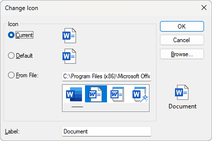

Change Icon Dialog Box
OLECONVERT (Command)
List of Options
The following options are displayed.
Icon
Specifies an icon to represent an embedded or linked object.
Current
Specifies the currently selected icon.
Default
Specifies the default icon for the source application.
From File
Specifies an icon from a file (valid types include EXE, DLL, and ICO).
Label
Specifies a caption for the icon. The file type is displayed unless you specify otherwise.
Browse
Displays the Browse dialog box (a standard file selection dialog box), in which you can select an icon from a file.
