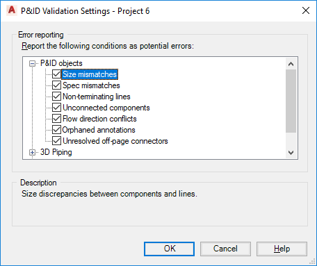

    To specify P&ID error types to flag
    1. On the ribbon, click Home tab Validate panel Validate Config.
    2. In the P&ID Validation Settings dialog box, in the Error Reporting tree, expand the P&ID objects and Base AutoCAD objects nodes. Select the check boxes for the error types to be flagged during project validation.
    3. Click OK.
