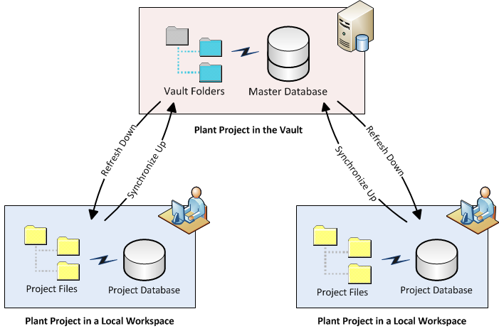

When you first open a plant project from the vault using the Project Manager, a local workspace is created and files are copied from the vault. Additional users create a separate local workspace.
The project database in the local workspace is updated (
) as you save files in the working folder. The project master database is updated when you check in files to the vault.
If you create a plant project in the vault, you can benefit form the following vault-enabled features:
- Local workspace - You no longer keep your working files on a network share. You modify vault projects files in your local workspace folder and synchronize them to the vault.
- Check-in and check-out document management - The Project Manager is fully integrated with Autodesk Vault. The Project Manager prompts you to check out files as you work.
- Automatic file versions - You can view or restore the previous revision of a file.
- Master project database - Vault projects use SQL Server for the project database. The master database is always synchronized to match the files that are checked in to the vault.

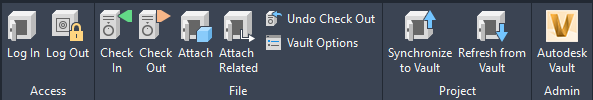

Vault Ribbon
You can manage your vault log-in session and vault project files from the ribbon.
Go to Vault in the ribbon loads Autodesk Vault Client (vault explorer). The Autodesk Vault Client login session is not the same as the
AutoCAD Plant 3D toolset session.
For more information on the ribbon commands, see the Vault Command Reference.
