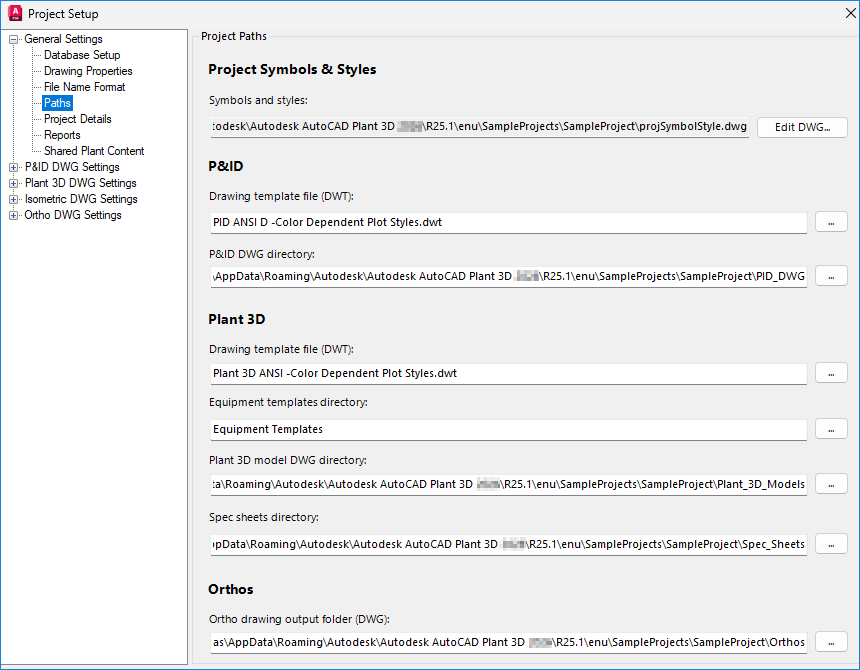

Paths (General Settings Tree Node)
Sets the paths and directories where users access symbols, reports, the project drawing directory, and so on.
Project Symbols & Styles
Displays the location where symbols are stored. You cannot edit this location.
Note: In a collaboration project, the Edit DWG button is enabled, allowing you to edit project symbols and styles for customization.
P&ID
Defines the P&ID paths.
Drawing Template File (DWT)
Defines the template file that displays by default when users open a project. You can browse to select a different file.
P&ID DWG Directory
Specifies the location of the project drawing directory. You can browse to set another location.
Plant 3D
Defines the Plant 3D project paths.
Specifies the location of the project model template directory. You can browse to select another location or template.
Equipment Template Directory
Specifies the location of the equipment template directory.
Plant 3D Model DWG Directory
Specifies the location of the project model directory. You can browse to set another location.
Spec Sheets Directory
Specifies the location where the spec sheets are stored. You can browse to select another location.
Orthos
Ortho Drawing Output Folder (DWG)
Specifies the location for ortho drawings. You can browse to select another location.
