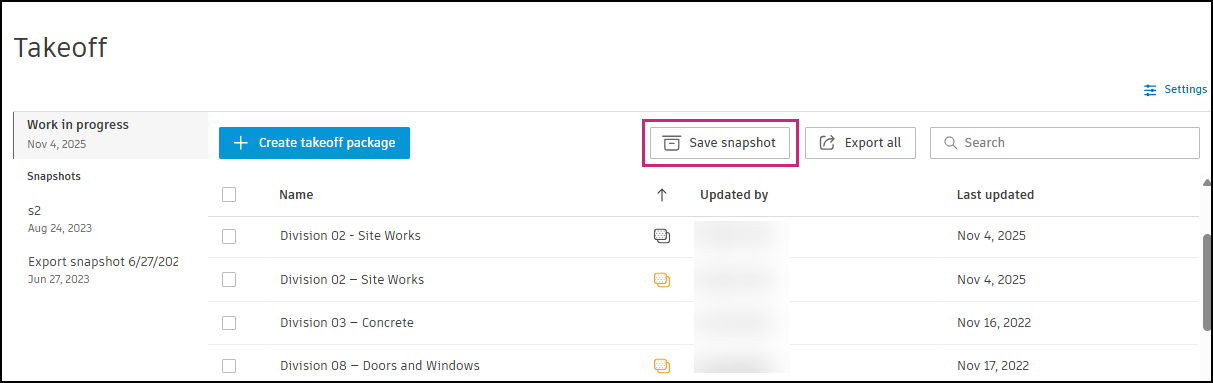

Navigate to the Takeoff tool in Preconstruction to save a snapshot for your project’s takeoff.
  1. Click the ‘Save snapshot’ button at the top of the packages list.
  2. This opens Save a project snapshot.
  3. Enter a name for the snapshot and click Save snapshot.
    Note:
    Saving a snapshot can take a couple of minutes. We recommend waiting to save other takeoff work in the project during this time to ensure your snapshot data is saved correctly. You can't make changes to a snapshot, including adding or removing takeoff.
    Once the snapshot has been saved, you’ll see the newly created snapshot in the Snapshots column. Select the snapshot to view the packages in the snapshot.
