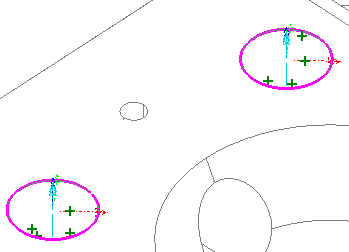

    To display probe centres
    Select the Point-Cloud tab > Display panel > Geometry-Point Mode > Probe Centres option to show the probe centre for measured points.
    The positions of the probe centres are shown as crosses on all features displayed in the CAD view. For example:
