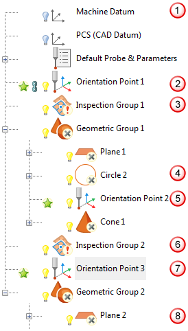

You can place Orientation Point items anywhere in the Definition level of the Sequence Tree. You can also use them within a geometric group to orient the probe before or after any item.
Note: Orientation Points are available only when creating inspections for use on OMV machines.
The following example illustrates the use of Orientation Points:
The inspection sequence starts by using the default (Machine Datum) to position and orient the probe.
The probe is transformed by Orientation Point 1.
In Inspection Group 1, Auto-Orientation is selected for the group's UserDefined probing method, so the probe is transformed before probing begins.
Note: If Auto-Orientation is not selected, the probe remains at the rotation specified inOrientation Point 1.
In Circle 2, Auto-Orientation is not selected, so, before the first point on the Circle 2 probe path is played, the probe is transformed back to Orientation Point 1 because it is the preceding orientation point.
Orientation Point 2 transforms the probe for Cone 1.
Inspection Group 2 does not use Auto-Orientation, so the probe uses the orientation of Orientation Point 1 because it is the preceding orientation point item at that level in the inspection sequence.
When the probing of Inspection group 2 is complete, the probe is transformed by Orientation Point 3.
If Geometric Group 2 contains any item in which Auto-Orientation is selected, the probe is transformed by the associated probing method. Otherwise, the probe remains at the rotation specified in Orientation Point 3.
