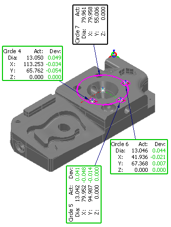

    To show automatic labels horizontally and vertically, click View tab > Labels panel > Geometry & Form > Standard Labels.
    The label text is displayed horizontally and vertically. For example:
    The orientation of each label depends on its position in the CAD view.
