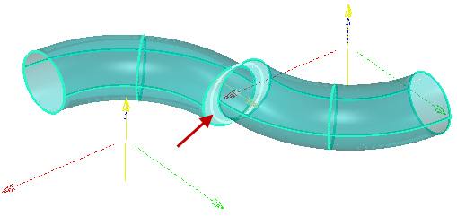

To construct a circle where two tori intersect
Use the Circle: Torus & Torus item to measure the constructed circle at the intersection of the minor circles of two tori.
The centre of the constructed circle is midway between the centres of the minor circles; the radius is the average of the radii of the two minor circles.
To create a Circle: Torus & Torus item:
