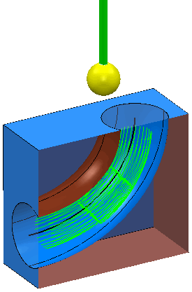

Use the Port Plunge Finishing strategy for plunge machining inside a port. Plunge machining automatically creates good retract moves.
All plunge toolpaths are continuous 5-axis toolpaths.
