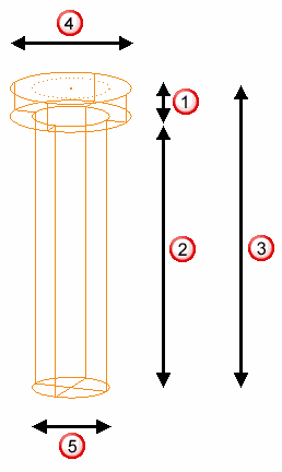

Compound holes contain several superimposed holes. For example:
- Compound holes contain two components:
The first component has a length
and diameter
. This has a Component of First.The second component has a length
and diameter
. This has a Component of Second or Last. - If you create individual holes you will create two holes:
The first hole has a depth
and diameter
.The second hole has a depth
and diameter
You can see the difference between the representation of a compound hole and an individual hole in the Hole Feature Sets created.

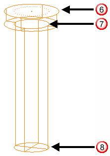

A compound hole can have a Top, Bottom and Component top.
The first component has a Top
and Bottom
The second component has a Top
, Component top
and Bottom
. This has a Component of Second.
