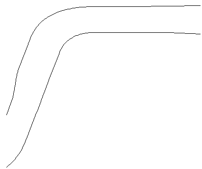

For example, if you start with these two curves:

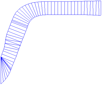

you will get something like:
Note: Increasing the Stepover value will increase the distance between the lines in the pattern.

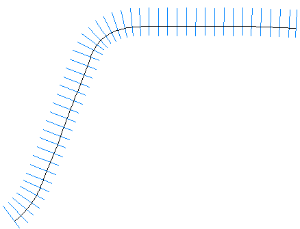

A Left Distance of 10 and a Right Distance of 5 creates the following Across pattern for a single curve:
